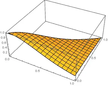

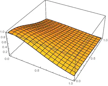

  1. "I don't get how by symmetry are we computing $I$ on $\{(u,v,w) : 0\le v\le u \le 1\}$."
A picture or two is worth a thousand words: setting $w=0$ (this doesn't change things), compare the whole and half ranges.
integral_1
integral_2
