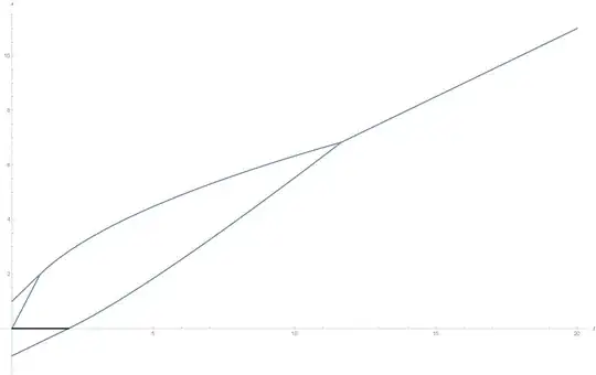

This gives you a full solution, and a picture of the shocks can be seen here:
You can readily see where each portion of the solution is assigned to in the picture as well.
