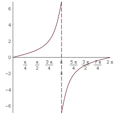

$$ F(x) = \dfrac{20}{\sqrt{21}} \arctan\left( \dfrac{\tan(x/2)}{\sqrt{21}}\right)$$
The problem is that $\tan(x/2)$ has a singularity at $x = \pi$: $\tan(x/2)$ is not defined there. If you plot it, you'll see that
$F(x)$ actually has a jump discontinuity:

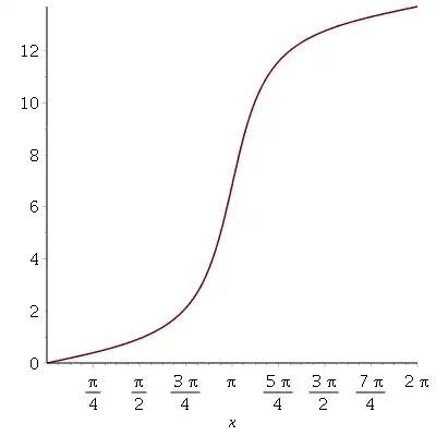

As $x$ approaches $\pi$ from the left, $\tan(x/2)/\sqrt{21}$ goes to $+\infty$, so arctan of that goes to $+\pi/2$, and $F(x)$ goes to $10 \pi/\sqrt{21}$. As $x$ approaches $\pi$ from the right, $\tan(x/2)/\sqrt{21}$ goes to $-\infty$, so arctan of that goes to $-\pi/2$, and $F(x)$ goes to $-10 \pi/\sqrt{21}$. Of course, the discontinuity means $F(x)$ is not really an antiderivative at $x = \pi$: a discontinuous function can't be differentiable. In order to get a correct antiderivative, you have remove the discontinuity, e.g. by adding $20 \pi/\sqrt{21}$ to the function on the right of $x=\pi$. Thus a correct antiderivative over this interval is $$ G(x) = \cases{\dfrac{20}{\sqrt{21}} \arctan\left( \dfrac{\tan(x/2)}{\sqrt{21}}\right) & for $x < \pi$\cr \dfrac{10 \pi}{\sqrt{21}}& for $x = \pi$\cr \dfrac{20}{\sqrt{21}} \arctan\left( \dfrac{\tan(x/2)}{\sqrt{21}}\right) + \dfrac{20 \pi}{\sqrt{21}} & for $x > \pi$\cr}$$ Here is its graph:
And the correct integral is $G(2\pi) - G(0) = 20 \pi/\sqrt{21}$.
