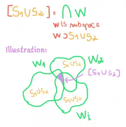

Update: To illustrate, I've made this figure: enter image description here
that shows some possible $W_i$ of the intersection on the definition.
My idea is: pick any $x\in [S_1\cup S_2]$, therefore this $x$ is in the purple intersection of the figure. If it is in the intersection, it is in all subspaces $W_i$. But since $W_i$ is a subspace that contains $S_1\cup S_2$, one of these subspaces can be $[S_1]+[S_2]$ because:
$$[S_1]+[S_2] = \{u+v| u\in [S_1], v \in [S_2]\}$$ And, remember, this is a subspace, but must also contain $S_1\cup S_2$ by the definition. But it contains, because we could show that there exists $2$ subsets of $[S_1]+[S_2]$ in the form:
$$w_1 = \{u+0|u\in [S_1], 0 \in [S_2]\} = [S_1] \supset S_1 $$ $$w_2 = \{0+v|0\in [S_1], v \in [S_2]\} = [S_2] \supset S_2 $$
Since both $w_1\supset S_1$ and $w_2\supset S_2$ are in $[S_1]+[S_2]$, then $w_1\cup w_2 = [S_1]\cup [S_2] \supset S_1\cup S_2$
I showed that such subspace $[S_1]+[S_2]$ matches the definition, so all $x\in [S_1\cup S_2]\subset [S_1]+[S_2]$.
