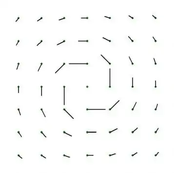

Flow velocities $(u,v)$ are obtained from the flow potential $\phi$ as follows: $$ u = \frac{\partial \phi}{\partial x} \quad ; \quad v = \frac{\partial \phi}{\partial y} $$ First transform to Cartesian coordinates and then take the derivatives: $$ \phi = \theta = \arctan(y/x) \quad \Longrightarrow \quad u = \frac{-y}{x^2+y^2} \; , \; v = \frac{x}{x^2+y^2} \quad \Longrightarrow \quad (u,v)= \frac{(-y,x)}{r^2} $$
Wikipedia reference:
You have an irrotational vortex with strength $2\pi$ and rotating counterclockwise:
