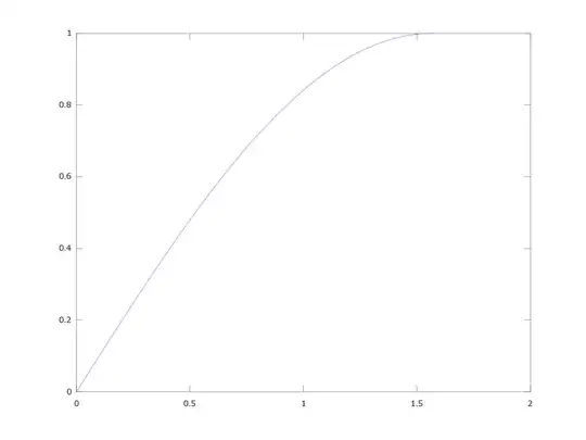

$g_1$
sin^1

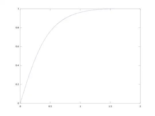

$g_{10}$
sin^10

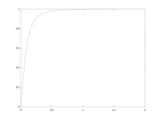

$g_{200}$
sin^200

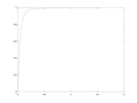

$g_{1000}$
sin^1000

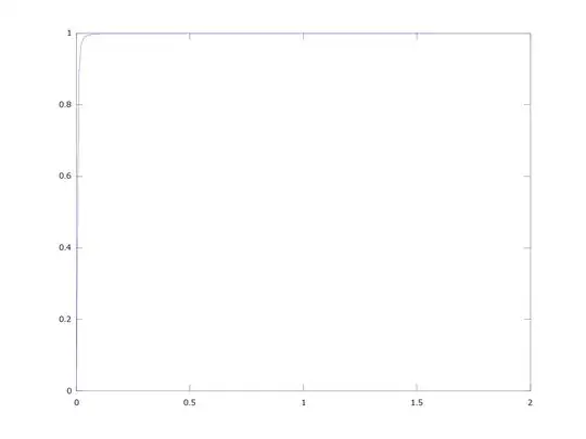

$g_{10000}$
sin^10000

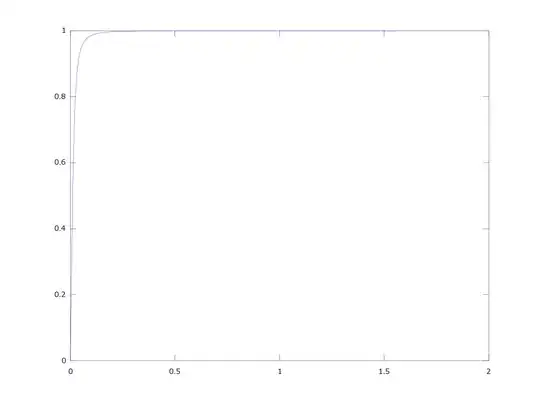

$g_{100000}$
sin^100000
