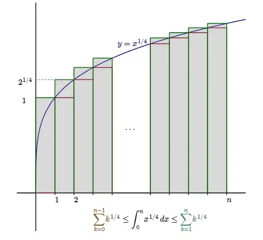

2Thank you. I've read the wikipedia link and now I think you mean something like this: looking at the interval $[0,n]$, subdivide it in $n$ subintervals. Then, $\sum^{n-1}k^{1/4}<\int_0^n x^{1/4} dx<\sum^n k^{1/4}$. The integral is just what you write. Is this correct? Can it be made more formal? And how can you get even more precise inequalities? Thanks again – quark1245 Jan 31 '12 at 11:56
Pretty much. See answer. – Did Jan 31 '12 at 12:40

Let $k\geqslant1$. Since the function $x\mapsto x^{1/4}$ is increasing, $(k-1)^{1/4}\leqslant x^{1/4}\leqslant k^{1/4}$ for every $k-1\leqslant x\leqslant k$. Integrating this double inequality yields $$ (k-1)^{1/4}\leqslant\int_{k-1}^kx^{1/4}\mathrm dx\leqslant k^{1/4}. $$ Summing these from $k=1$ to $k=n$ yields $$ s_{n-1}=\sum_{k=0}^{n-1}k^{1/4}\leqslant\int_{0}^nx^{1/4}\mathrm dx\leqslant \sum_{k=1}^{n}k^{1/4}=s_n. $$ Since the integral is $\tfrac45n^{5/4}$ and $s_{n-1}=s_n-n^{1/4}$, this yields, for every $n\geqslant1$, $$ \tfrac45n^{5/4}\leqslant s_n\leqslant\tfrac45n^{5/4}+n^{1/4}. $$ Note finally that $n^{1/4}=o(n^{5/4})$ hence a (much weakened) version of this is $s_n\sim\tfrac45n^{5/4}$.
