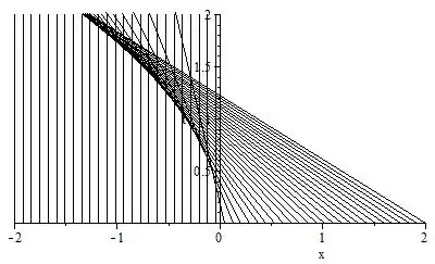

As suggested by @Saad, setting $t=0$ in $u(x,t)$ gives the initial data $$ u(x,0) = g(x) = \left\lbrace \begin{aligned} &{-{2}}\sqrt{{x}/{3}} & &\text{if}\quad x>0, \\ &0 & &\text{if}\quad x<0 . \end{aligned} \right. $$ Instead of proving directly that $u$ is an entropy-condition-satisfying weak solution, let us derive the entropy solution to this initial-value problem and compare with the proposed $u$. We first derive a classical solution by applying the method of characteristics for short times. As long as the method of characteristics is valid, we have $u=g(x-u t)$. According to the expression of $g$, two cases must be considered:
  • for $x$ sufficiently small, $g(x)=0$, so that $u(x,t)=0$;
  • for $x$ sufficiently large, $g(x) = -2\sqrt{x/3}$, so that $u(x,t)={-\frac{2}{3}}\big(t+\sqrt{3x+t^2}\big)$.
Below is a plot of the characteristic curves in the $x$-$t$ plane deduced from the initial data:
characteristics
An intersection of the characteristic lines is observed around the origin, and the method of characteristics fails there. According to the Lax entropy condition, a shock wave is generated. Its position $x_s(t)$ must satisfy the Rankine-Hugoniot condition to ensure that such a wave is a weak solution. Therefore, the shock speed is given by $$ x'_s(t) = \frac{1}{2}\left( 0 - \frac{2}{3}\big(t+\sqrt{3 x_s(t)+t^2}\big) \right) $$ with initial position $x_s(0)=0$, i.e., $x_s(t) = -t^2/4$. By construction, the (unique) entropy solution is therefore $$ u(x,t) = \left\lbrace \begin{aligned} &{-\frac{2}{3}}\big(t+\sqrt{3x+t^2}\big) & &\text{if}\quad x>-t^2/4, \\ &0 & &\text{if}\quad x<-t^2/4 , \end{aligned} \right. $$ which ends the proof.
