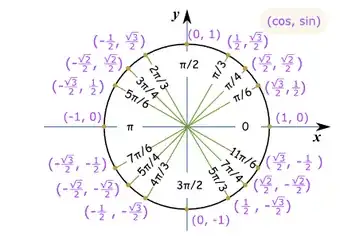

Assertion: For every $k$, either $|\sin(3k)|\geqslant\frac12$ or $|\sin(3k+1)|\geqslant\frac12$ or $|\sin(3k+2)|\geqslant\frac12$. Hence the series diverges.
Hint:
The assertion above uses the identity $\sin\left(\frac\pi6\right)=\frac12$ and the inequality $\mathsf{length}\left([-\frac\pi6,\frac\pi6]\right)\lt2$.
$\qquad\qquad\qquad$enter image description here
