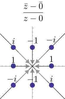

Holomorphic is just talking differentiability in the complex plane.
For example, in Real analysis, we look at the left and right limits only.
whereas here we are looking in all possible directions. Here we are giving eight of those possibilities in the diagram.
Not holomorphic
Analytic
Suppose a complex-valued function is holomorphic in all points of a domain then it is called as an analytic function. Hope this helps.

  • If I may make a slightly off-topic comment, the profusion of ellipses is a bit distracting-and doesn't seem to communicate anything very specific. – Kevin Carlson Nov 21 '14 at 17:09
  • i could not understand what you are concluding from this... please be frank and give details.. hope will help me to learn correctly... please..@Kevin – David Nov 21 '14 at 17:18
    I was just suggesting you use "..." less and stick to the punctuation "." for most sentences. It wasn't a mathematical comment. To make a mathematical comment, your edit isn't very clear. It seems to imply the issue with holomorphicity is of directional derivatives in oblique directions, but differentiable functions on $\mathbb{R}^2$ already have this property. It's the Cauchy-Riemann equations that make holomorphic functions something special, yes? – Kevin Carlson Nov 21 '14 at 17:20
  • yes..you are right...@Kevin – David Nov 21 '14 at 17:24
