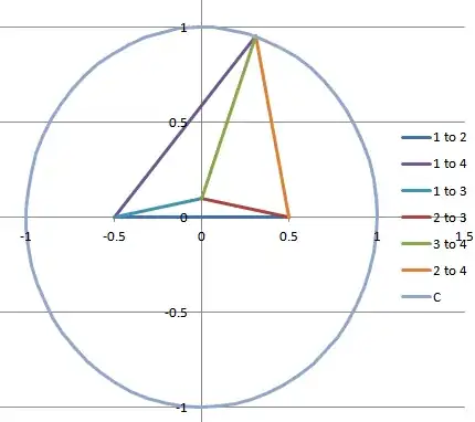

As my result has been challenged I will add more details as to what I believe the original question is asking, and how I achieved my results.

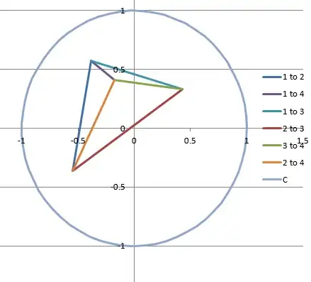

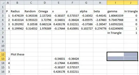

I actually set it up in an Excel spreadsheet so not only could I calculate things, I could graphically see if the results were correct at the same time.
Below is what the spreadsheet is looks like Excel spreadsheet showing in triangle And this the graph showing the same four points with 4 inside the triangle of points 1 through 3 Graph showing in triangle
Here is what the formulas in the spreadsheet are.
The Radius & Random column both just contain =RAND()
For the Omega Column the first cell contains =C3*2*PI() i.e. $Random*2*\pi$ and this copied down for the other three cells.
For the x column the first cell contains =SQRT(B3)*COS(D3) and again copied down
For the y column the first cell contains =SQRT(B3)*SIN(D3) and again copied down
I then defined the x and y columns with names of p1.x, p1.y, p2.x, p2.y etc. this is so I could easily use the barycentric coordinates formula and update them for each point.
For the alpha
(G3) =((p3.y - p4.y)*(p1.x - p4.x) + (p4.x - P3.x)*(p1.y - p4.y)) / ((p3.y - p4.y)*(P2.x - p4.x) + (p4.x - P3.x)*(p2.y - p4.y))
(G4) =((p3.y - p4.y)*(P2.x - p4.x) + (p4.x - P3.x)*(p2.y - p4.y)) / ((p3.y - p4.y)*(p1.x - p4.x) + (p4.x - P3.x)*(p1.y - p4.y))
(G5) =((p1.y - p4.y)*(P3.x - p4.x) + (p4.x - p1.x)*(p3.y - p4.y)) / ((p1.y - p4.y)*(P2.x - p4.x) + (p4.x - p1.x)*(p2.y - p4.y))
(G6) =((p3.y - p1.y)*(p4.x - p1.x) + (p1.x - P3.x)*(p4.y - p1.y)) / ((p3.y - p1.y)*(P2.x - p1.x) + (p1.x - P3.x)*(p2.y - p1.y))
For beta
(H3) =((p4.y - p2.y)*(p1.x - p4.x) + (P2.x - p4.x)*(p1.y - p4.y)) / ((p3.y - p4.y)*(P2.x - p4.x) + (p4.x - P3.x)*(p2.y - p4.y))
(H4) =((p4.y - p1.y)*(P2.x - p4.x) + (p1.x - p4.x)*(p2.y - p4.y)) / ((p3.y - p4.y)*(p1.x - p4.x) + (p4.x - P3.x)*(p1.y - p4.y))
(H5) =((p4.y - p2.y)*(P3.x - p4.x) + (P2.x - p4.x)*(p3.y - p4.y)) / ((p1.y - p4.y)*(P2.x - p4.x) + (p4.x - p1.x)*(p2.y - p4.y))
(H6) =((p1.y - p2.y)*(p4.x - p1.x) + (P2.x - p1.x)*(p4.y - p1.y)) / ((p3.y - p1.y)*(P2.x - p1.x) + (p1.x - P3.x)*(p2.y - p1.y))
For gamma the first cell contains =1-G3-H3 and copied down
For in triangle the first cell contains =IF(G3<=0,0,IF(H3<=0,0,IF(I3<=0,0,1))) and copied down
For (J7) =SUM(J3:J6)
And if you are wondering about the Plot section, that was just so I could get the graph to draw each line independently making it possible to work out which point is which visually. I also have another section of static data, which is not shown, to draw the circular line.

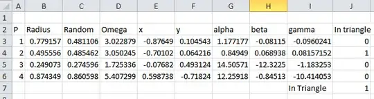

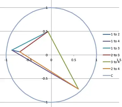

Here is another example of one of the points being within the other three, in this case point #2
Point 2 numbers Point 2 graphics

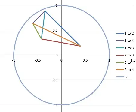

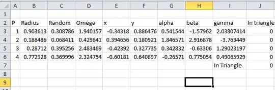

And here is an example of no points falling with the triangles.
Not in numbers Not in graphic
Because the RAND() causes the values to change each time, I set up a table with rows 1-10 and columns 1-10 and record the result 0 or 1 in each cell. Then afterwards you can just get an average of them to determine the percentage of ones where one of the points is in the triangle of the other three points. Very manual I know but it allows you to visibly check the results each time.
Please feel free to reproduce this, or if you like I can publish the spreadsheet so you can download it.

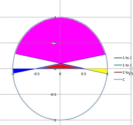

Given a triangle in a circle, the chance of a random point landing in the triangle is the area of a triangle divided by the area of a circle.
Area of triangle = $\lvert P1.x*(p2.y-p3.y)+P2.x*(p3.y-P1.y)+P3.x*(P1.y-p2.y) \rvert \over 2$
Area of a circle = $\pi r^2$
So probability = $\lvert P1.x*(p2.y-p3.y)+P2.x*(p3.y-P1.y)+P3.x*(P1.y-p2.y) \rvert \over 2 \pi r^2$
Lets say we have a triangle with
$P_1(x,y)=(-0.5,0)$
$P_2(x,y)=(0.5,0)$
$P_3(x,y)=(0,0.1)$
Then there are four areas the fourth points can land it so that one of the points is in a triangle. The additional areas are those where if you extend the lines of the original triangle so that they intersect the circle. The areas that lie between the point and the circle will also cause a triangle to form with one of the points in it. The blue area for point 1, the yellow for point 2 and the pink for points 3.
Known triangle
This is most clearly shown with point 3 in triangle formed by points 1,2 & 4 Point 3 in triangle
So we have to add those three areas to the triangular area to work out the probability.
However that is rather complicated as you would have to work out the intersections to the circle and work out the average size of pie shaped areas. There is an easier approach for, see my other answer which gives the mathematics.
