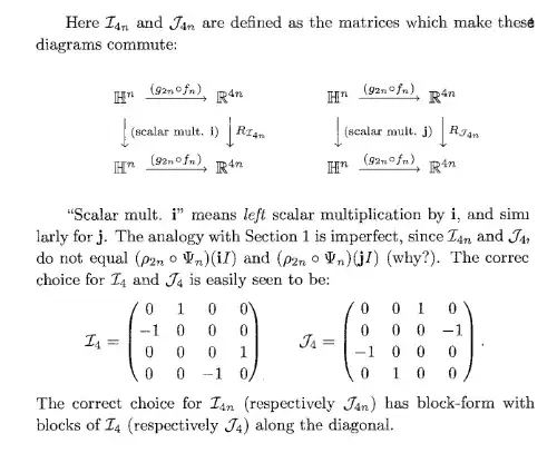

After the discussion with Incnis Mrsi I calculated $J^2=I^2 =-1$ for $J=\rho_{2}(\psi_1(j))$ and $I=\rho_{2}(\psi_1(i))$. I am confused that this seems to work. The reason why I asked this quetion is the following passage in Tapp's matrix groups for undergraduates:
In particular,
why is $I\neq\rho_{2n}(\psi_n(i))$ and $J\neq\rho_{2n}(\psi_n(j))$ for $n>1$? (for $n=1$, apparently it works as I just verified).

  • I did both calculations in $1$ dimension again and verified that indeed $I^2 = J^2 = -1$. The problem is: it is a comment in my book that this does not work. Is it a mistake in my book? (I am about take a screenshot and also link to the sentence.) – learner Dec 26 '14 at 23:57
  • Maybe it has something to do with what you write in the second part of your answer. Maybe there are two ways to evade problems with the fact that $\mathbb H$ is only a skew-field: one is to use different equations that we want to hold in the real matrices and the other is to use different matrices for $I$ and $J$ so as to make $I^2 =J^2=-1$ and the other quaterion equations still hold? – learner Dec 27 '14 at 00:15
  • And the paragraph in the book seems to contradict your last paragraph: the book suggests that indeed we can find real representations of $\mathfrak I := iI$ and $\mathfrak J := jI$ such that a real matrix $M$ is quaternionic linear if and only if $M\mathfrak J = \mathfrak J M$ and $M\mathfrak I = \mathfrak I M$. Or am I misunderstanding the section in the book which I included in the question? – learner Dec 27 '14 at 11:11

Now, working in n=1 for simplicity, we have the homomorphisms: $$ \rho_2 \circ \psi : \mathbb{H} \rightarrow M_4(\mathbb{R}) $$ so defined: $$ \begin{split} \rho_2 \circ \psi(x)=\rho_2(\psi(x))=\rho_2(X_{(2)}) &= \\ = \left[ \begin{array}{ccccc} \rho(x_0+ix_1)&\rho(x_2 +ix_3) \\ \rho( -x_2+ix_3) &\rho(x_0-ix_1) \end{array} \right] &=\\ = \left[ \begin{array}{ccccc} x_0&x_1&x_2 &x_3 \\ -x_1&x_0&-x_3 &x_2 \\ -x_2&x_3&x_0 &-x_1 \\ -x_3&-x_2&x_1 &x_0 \end{array} \right] = X_{(4)} \end{split} $$ note that the rows of this matrix are the ordered quadruples of the components of the quaternionic vector $$ \left[ \begin{array}{ccccc} 1x \\ \mathbf{i}x\\ \mathbf{j}x \\ \mathbf{k}x \end{array} \right] $$ so we adopt the useful notation: $$ \rho_2 \circ \psi(x)= \left[ \left[ \begin{array}{ccccc} 1x \\ \mathbf{i}x\\ \mathbf{j}x \\ \mathbf{k}x \end{array} \right] \right] $$ now it's easy to see that $$ \rho_2 \circ \psi(\mathbf{i})=I_{(4)}= \left[ \left[ \begin{array}{ccccc} \mathbf{i} \\ -1\\ -\mathbf{k} \\ \mathbf{j} \end{array} \right] \right] = \left[ \begin{array}{ccccc} 0&1&0 &0 \\ -1&0&0 &0 \\ 0&0&0 &-1 \\ 0&0&1 &0 \end{array} \right] $$ as in OP and, in the same way, we can find $J_{(4)}=\rho_2 \circ \psi(\mathbf{j})$ and $K_{(4)}=\rho_2 \circ \psi(\mathbf{k})$.
And, more important, we easily see that $$ \rho_2 \circ \psi(\mathbf{i}x)= \left[ \left[ \begin{array}{ccccc} 1\mathbf{i}x \\ \mathbf{i}\mathbf{i}x\\ \mathbf{j}\mathbf{i}x \\ \mathbf{k}\mathbf{i}x \end{array} \right] \right]= \left[ \left[ \begin{array}{ccccc} \mathbf{i}x \\ -x\\ -\mathbf{k}x \\ \mathbf{j}x \end{array} \right] \right] $$ is different from $$ \mathbf{i} \left(\rho_2 \circ \psi(x)\right)= \mathbf{i} \left[ \left[ \begin{array}{ccccc} 1x \\ \mathbf{i}x\\ \mathbf{j}x \\ \mathbf{k}x \end{array} \right] \right]= \left[ \left[ \begin{array}{ccccc} \mathbf{i}x \\ -x\\ \mathbf{k}x \\ -\mathbf{j}x \end{array} \right] \right] $$ but we have: $$ \rho_2 \circ \psi(\mathbf{i}x)=\rho_2\left[\psi(\mathbf{i})\psi(x)\right]=\rho_2\left(\psi(\mathbf{i})\right)\rho_2\left(\psi(x)\right) $$ so that the diagram in OP commutes if we take, on the right side, $I_{(4)}=\rho_2\left(\psi(\mathbf{i})\right)$. I think that, with a bit of work, we can extend this reasoning to the case $n>1$.
I hope this can be an answer to the question. I'm not sure in my understanding of the page of the book, but I suspect that there is a mistake in the matrices named $\mathcal{I}_4$ and $\mathcal{J}_4$.
