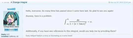

While browsing on Integral and Series, I found a strange integral posted by @Sangchul Lee. His post doesn't have a response for more than a month, so I decide to post it here. I hope he doesn't mind because the integral looks very interesting to me. I hope for you too. :-)
$$\mbox{How does one prove}\quad \int_{-\infty}^{\infty} {{\rm d}x \over 1 + \left[\,x + \tan\left(\, x\,\right)\,\right]^{2}} = \pi\quad {\large ?} $$
Please don't ask me, I really have no idea how to prove it. I hope users here can find the answer to prove the integral. I'm also interested in knowing any references related to this integral. Thanks in advance.
