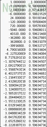

Summations of divergent series, if they have alternating signs, can be done by summation-methods using infinite sized matrices. One example is the Euler-summation, which can be expressed by the "binomial" transform of a series. In matrix form this is done for instance this way.
I. Let $A$ be the column-vector containing the terms of a divergent series with alternating signs. The growthrate for that terms must not exceed geometrical growth, so the quotient $q$ of two consecutive term is allowed at most of constant absolute value.
With this we use two lower triangular matrices, first the matrix for partial summation, (I call it "Dr" in my Pari/GP-toolbox ) and we get $$ \operatorname{Dr} \cdot A = B $$ where the column-vector $B$ contains now the partial sums. After that, using the Pascalmatrix $P$, normed to have rowsums equal to 1, allow $$ \operatorname{RowNorm}(P) \cdot B = C $$ and the sequence of entries in $C$ might now converge to some finite value, which is taken as the Euler-Sum of the series described by $A$. It is optimal for such summations to have an adapted power of the matrix $P$, and what I actually do is to use the matrix-logarithm of $P$ and construct powers of it.
The logarithm, say $L$ of $P$ is just the matrix with the first subdiagonal containing the values $[1,2,3,4,..]$, and a general power of $P$, for instance the h'th power, is $ P^h = \exp(h \cdot L) $ so an Euler-sum of order $h$ is $$ \operatorname{RowNorm}(P^h) \cdot \operatorname{Dr} \cdot A = C $$ and I also include the dotproduct with the $Dr$ - matrix into one matrix-call in Pari/GP which is now my standard-use: $$ \operatorname{ESum}(h) \cdot A = C$$ which means an Eulersum to order $h$ of the series described by the columnvector $A$. Here the entries of $\small \operatorname{ESum}$ contain the final weights for the summation.
II. The weights for summations of higher orders in my studies are taken by the same scheme, where however the entries of the logarithm-matrix $L$ are taken to some power. For instance, if I use $ \small L_2 = \operatorname{SubDiag}([1,2^2,3^2,4^2,...]) $ then I get Noerlund-weights of order $2$, and in Pari/GP I write $ \small \operatorname{NoerSum}(o,h)$ where $o$ denotes now the exponent to which I take the $L$-matrix-terms. So I can do
$$ \operatorname{NoerSum}(2,1) \cdot A = C$$ where $A$ can now contain the factorials with alternating signs. With matrices of size of only, say, $32x32$ I get the following partial sums in $C$:
$\qquad $ picture
where the first column shows the values to be summed, and the second column show the terms of $ \small C = \operatorname{NoerSum}(2,1.0) \cdot A$ which converge to the expected (divergent) sum of the alternating factorials.

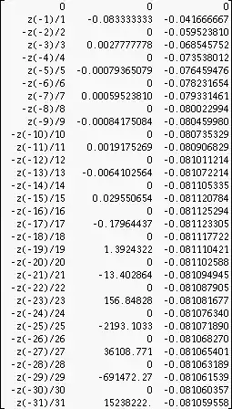

III. Finally, here is the sequence of partial sums, where I Noerlund-summed with the parameters (2,1) the first series in question, namely with the Stirlingnumbers 1st kind, scaled by the reciprocal factorials (of which is $\log(1+x)$ is the generating-function) : in the first column the symbolic description ($\zeta$ denoted by $z$), in the second column the numerical values of the terms of the series to be summed, and in the third column that final partial sums, taken by Noerlund-sum.
$\qquad $ picture
(small remark: the parameters for the Noerlundsum could have been optimized, but I just left it here for comparable matrix-construction)
