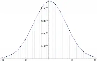

The second derivative of $\log\binom{2n-1}{n-k}$ between $k=0$ and $k=1$ is $-\frac2n$. This means that a good approximation for $\binom{2n-1}{n-k}$ is $\frac{2^{2n-1}}{\sqrt{\pi n}}e^{-(k-\frac12)^2/n}$. For example at $n=100$,
$\hspace{3.4cm}$enter image description here

$(2)$: approximate the binomial by the appropriate normal distribution
$(3)$: cancel terms and apply Dominated Convergence (or Monotone Convergence, either works)
