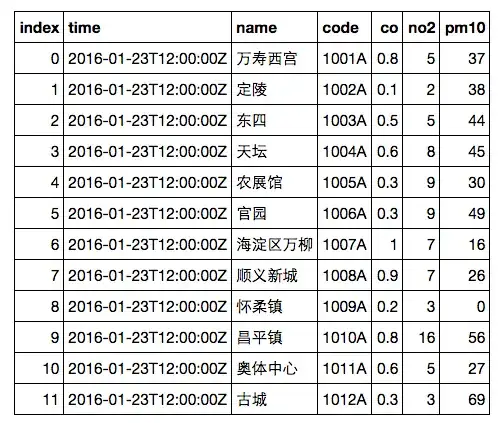

My result
Some pre-explanation
  • Ignore the chinese character in the table.
  • I only grab one city(Beijing here)'s data, and index from 0-11 notify that Beijing has 12 monitor site.
  • The columns 'co'/'NO2'/'PM10' represent the concentration of these air pollutants.
