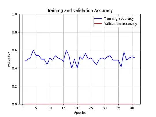

PREDICTIONS[[0.50033516 0.50027233 0.50031793 0.500271 0.50022817 0.5003597 0.50027865 0.50018543 0.50036544 0.50030404 0.500344 0.50030637 0.50027204 0.5002804 0.50025326 0.50039023]] array([[1., 1., 1., 0., 0., 1., 0., 0., 0., 1., 0., 1., 1., 1., 0., 0.]],
The focus should be on the PREDICTION vector which hold values which are near 0.5. that makes me think that my network is confused and cannt decide wether images are similar or not. Do notice one vector below is the 'Ground Truth' I couldnt figure out how to fix it. I tried adding some Dropouts, BatchNorms, Regularization (for last Dense layer's filters in the CNN part).
I have tried so many combinations and yet my model wont learn, and I couldnt think of any more ways that I can make it work.
Any help would be very appreciated.

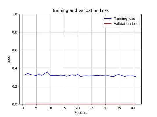

The Training Procedure looks as in the graph below (Note, there is no validation set yet, although im willing to split the LFW set to get some validations): enter image description here enter image description here
I had many small implementation problems, mostly on the data generation side. 2 main problems which I remember made a big change:
  1. I have changed "steps_per_epoch" to some big number and chose "epochs =1" which is obviously wrong, since the network should iterate over the whole dataset a couple of times before it gets a decision. If the dataset is big enough, "steps_per_epoch" shouldn't be defined and it will be the batch count of the dataset by default
  2. I have implemented my generator in such way that it will always generate a balanced batch. The important thing to notice is that the whole dataset is balanced, the batches dont really matter (at least wheb speaking of image processing problems).
  3. In this forum my network used "separable conv2d" which is known for being quicker and less memory consumer, but it didnt work for me, and changing those layers to the classic "Conv2D" made a big change
  4. Only one Dense layer doesnt really work that good, and I added some more of those layers with different architectures.
