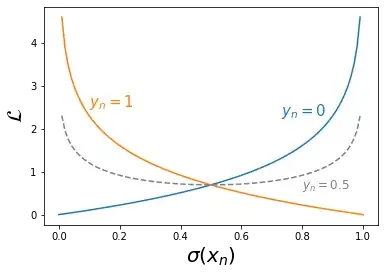

Binary cross entropy is intended to be used with data that take values in $\{0,1\}$ (hence binary). The loss function is given by, $$ \mathcal{L}_n = - \left[ y_n \cdot \log \sigma(x_n) + (1 - y_n) \cdot \log (1 - \sigma(x_n)) \right]$$ for a single sample $n$ (taken from Pytorch documentation) where $\sigma(x_n)$ is the predicted output.
For $y_n=0$ or $y_n=1$, the loss function as a function of $\sigma(x_n)$ is only 0 if $\sigma(x_n)=0$ or $\sigma(x_n)=1$, as you can see in the plot below. And although it's not what is intended with the binary cross entropy loss, you could in principle have a target value of $y_n=0.5$, and the loss would reach its minimum at $\sigma(x_n)=0.5$, though the loss would not be equal to 0.
In the plot below I show the loss function $\mathcal{L}(\sigma(x_n))$ for various values of the target $y_n$: enter image description here
