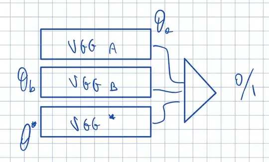

I would like to create 3 different VGGs with a shared classifier. Basically, each of these architectures has only the convolutions, and then I combine all the nets, with a classifier.
For a better explanation, let’s see this image:
I have no idea on how to do this in Pytorch. Do you have any examples that can I study? Is this a case of weights sharing?
Edit: my actual code. Do you think is correct?

Everything seems good but you are not taking any outputs from model1, model2 and model_star?
Here is how I would code this thing -

def forward(self,x1,x2,x3): op1 = self._vgg_a(x1) op2 = self._vgg_b(x2) op3 = self._vgg_c(x3) xc = torch.cat((op1,op2,op3),0) xc = self.classifier(xc)
  return xc
model = VGG16Classifier() ip1 = torch.randn([1, 1, 32, 32]) ip2 = torch.randn([1, 1, 32, 32]) ip3 = torch.randn([1, 1, 32, 32])
Model inference
print(model(ip1,ip2,ip3).shape) # torch.Size([3, 1])
Training also becomes straight forward, you can do it just like we do it for any other network. For eg defining optimizer like -
optimizer = optim.SGD(model.parameters(), lr=0.01, momentum=0.9)
And similarly loss and optimizer steps also remains same -
loss.backward()
optimizer.step()
