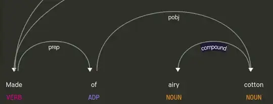

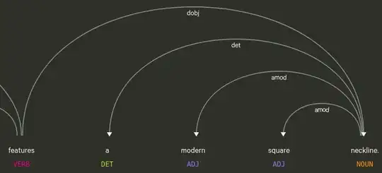

You can try using dependency parsing for that, e.g., as implemented in Spacy or any other NLP toolkit.
The details should be adjective modifiers (dependency label amod) of what you call attribute that you detected using a NER-like approach.
Alternatively, they can form compound nouns as "airy cotton" in your example. In this case, it is a word that depends on the entity with the dependency label compound. But I guess this will be rarely the case because such compounds will be more often recognized as one entity.
Spacy has an online demo for dependency parsing.
