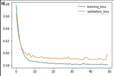

Here is the validation curves:
Validation curves

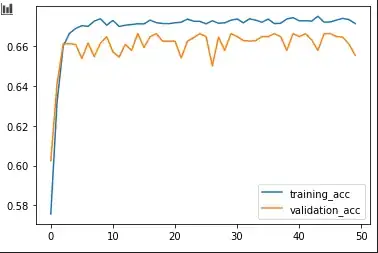

Here is the accuracy curves:
Accuracy curves
As you can see the validation loss is very high, and the accuracy is not too high, which to me the model is failing.
What do these outputs mean? In the sense of with all the experimentation I still cannot get the validation loss low with high accuracy. This to me is that the model is incorrect. But what would be the correct model? Is there any advice that can be given to better understand how to move forward and build a better model?

500K is decent data size. So, we can have a larger test set and also the network should be bigger.
Try the below listed suggestions -
  • Have a bigger model e.g. 200 Neurons, 5-6 layers
  • The test set should be 25%-30% since you have a decent dataset size
  • Keep LR to default
  • Increase batch size a bit as it's still fluctuating
  • Data should be standardized
  • Try adding Regularization when it starts overfitting
10xAI
