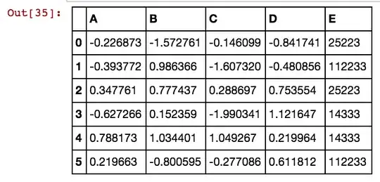

Simple small dataframe -
import numpy as np
import pandas as pd
X11 = pd.DataFrame(np.random.randn(6,4), columns=list('ABCD'))
X11['E'] = [25223, 112233,25223,14333,14333,112233]
X11
simple small dataframe

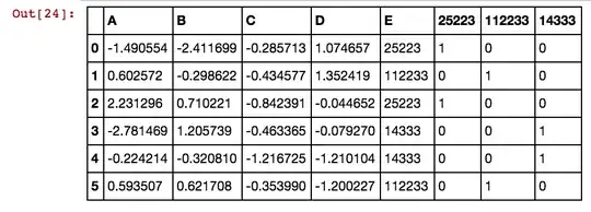

Binarization method -
for x in X11.E.unique():
    X11[x]=(X11.E==x).astype(int)
X11

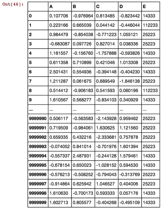

Dataframe with 10 Million rows -
pd.set_option("display.max_rows",20)
X12 = pd.DataFrame(np.random.randn(10000000,4), columns=list('ABCD'))
foo = [25223, 112233,25223,14333,14333,112233]
bar=[]
import random
for x in range(10000000):
    bar.append(random.choice(foo))
X12['E'] = bar
X12

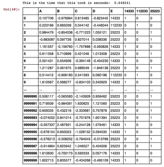

Timed binarization (aka one-hot encoding) on 10 million row dataframe -
import time
start = time.clock()
for x in X12.E.unique():
    X12[x]=(X12.E==x).astype(int)
elapsed = (time.clock() - start)
print "This is the time that this took in seconds: ",elapsed
X12
Hope this helps!
