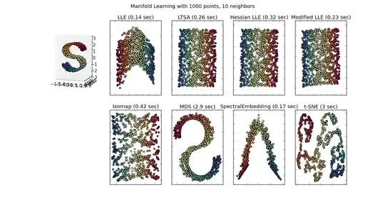

There are many techniques for visualizing high dimension datasets, such as T-SNE, isomap, PCA, supervised PCA, etc. And we go through the motions of projecting the data down to a 2D or 3D space, so we have a "pretty pictures". Some of these embedding (manifold learning) methods are described here.

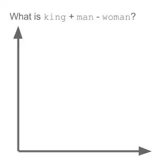

Take the example:
vector("king") + vector("man") - vector("woman") = vector("queen")
http://multithreaded.stitchfix.com/blog/2015/03/11/word-is-worth-a-thousand-vectors/

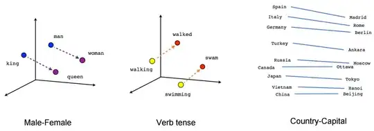

Here each direction encode certain semantic features. The same can be done in 3d
https://www.tensorflow.org/versions/master/images/linear-relationships.png
(source: tensorflow.org)
See how in this example past tense is located in a certain position respective to its participle. The same for gender. Same with countries and capitals.

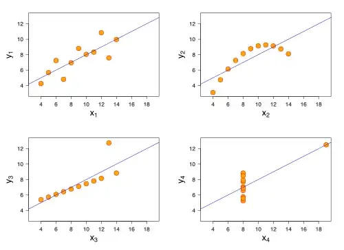

Richard Hamming is attributed with the sentence: "The purpose of computing is insight, not numbers." In this 1973 academic paper (see discussion in What is the famous data set that looks totally different but has similar summary stats?), Francis Anscombe argues that "graphs are essential to good statistical analysis." Anscombe's quartet is a long time favorite: same stats and regression, low dimension, yet very different behavior, regarding noise, outliers, dependancy. The projection of data in 11 dimensions onto two dimensions shown below is quite misleading: one has correlation and dispersion, the second (bottom down) has exact match, except one outlier. The third has clear relationship, but not linear. The fourth shows the variables are potentially not related, except for a threshold.

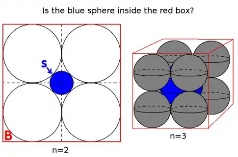

Last example: put touching $n$-spheres in an $n$-cube (the bubble inside the box, taken from Do good mathematicians visualize everything (even algebra)?):
Pizza box paradox
In two dimensions, the center blue ball is small. In 3D too. But very quickly, the center ball grows and its radius exceeds that of the cube. This insight is vital n clustering, for instance.
