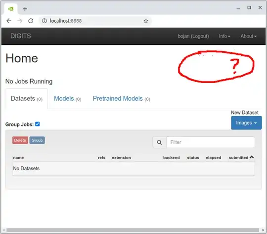

I am running DIGITS Docker container but for some reason it fails to recognize host's GPU: it does not report any GPUs (where I expect 1 to be reported) so in the upper right corner of the DIGITS home page there is no indication of any GPUs and also during the training phase, DIGITS uses only CPU.

Would anyone be kind to give me a hint why DIGITS running in Docker does not recognize my graphics card?
I found the answer. https://docs.nvidia.com/datacenter/cloud-native/container-toolkit/install-guide.html#platform-requirements specifies compute capability requirements for NVIDIA Container Toolkit but compute capability requirements for DIGITS Docker image are specified for each image release. For digits:20.12 https://docs.nvidia.com/deeplearning/digits/digits-release-notes/rel_20-12.html#rel_20-12 states the following:
Release 20.12 supports CUDA compute capability 6.0 and higher.
My GPU does not meet that requirement.
