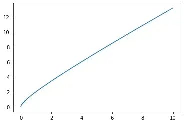

Having very high correlation means they are very nearly in a linear relationship, but it is possible that the deviation from linearity is not random, and in fact is predictive. Here's a simple example:
import numpy as np
from sklearn.linear_model import LinearRegression
from sklearn.model_selection import cross_val_score, KFold
x1 = np.linspace(0, 10, num=1000) x2 = x1 + np.sqrt(x1) X = np.vstack([x1, x2]).T y = np.sqrt(x1) # so y = x2 - x1
plt.plot(x1, x2);
print(np.corrcoef(x1, x2)) # = 0.9991
lr = LinearRegression() cv = KFold(shuffle=True, random_state=314)
print(cross_val_score(lr, X, y, cv=cv).mean()) print(cross_val_score(lr, x1.reshape(-1,1), y, cv=cv).mean()) print(cross_val_score(lr, x2.reshape(-1,1), y, cv=cv).mean())
outputs
1.0
0.9592797987922872
0.9741089428341769
and the plot of $x_1$ vs $x_2$:
nearly linear plot, with curve near the origin from the sqrt term
