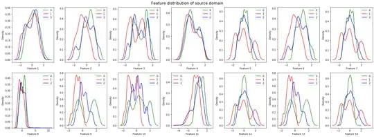

I have a source dataset with features, which do not follow a gaussian distribution:

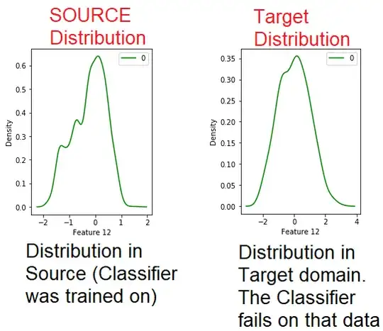

I can train classifiers with high accuracies with less effort. BUT: My validation data (target domain) has features with a distribution which is also not gaussian but which differ from the distribution the classifier was trained on.
E.g., we compare the distribution of the same feature for class 0 in source and target domain:

The problem I am facing is the same: The model trained on the source data (to ~98% valid. acc) fails on the target data with null-accuracy like (~30%). To validate that the problem is not only caused by the feature set (some features shown above) I tried a neural network approach. I am having the same problem if I train a neural network on the raw time series data, train/test is okay but performance on unseen instances is about null-accuracy only.
