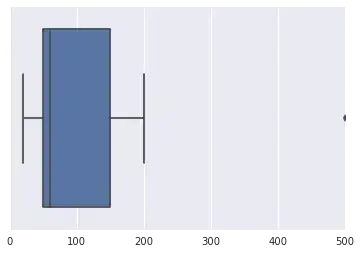

You can use BoxPlot for outlier analysis. I would show you how to do that in Python:
Consider your data as an array:
a = [100, 50, 150, 200, 35, 60 ,50, 20, 500]
Now, use seaborn to plot the boxplot:
import seaborn as sn
sn.boxplot(a)
So, you would get a plot which looks somewhat like this:
Seems like 500 is the only outlier to me. But, it all depends on the analysis and the tolerance level of the analyst or the statistician and also the problem statement.
