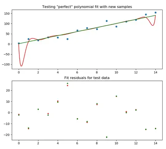

To give a simple illustration of how bad overfitting can be, consider the example of fitting (training) a polynomial of order equal to the number of points of data you have. In this case I've generated data with a slope and some normally distributed random noise added. If you test it with exactly the same x & y values that you used to generate the polynomial fit by looking at the residuals, all you see is the numerical error, and you might naively say it's a good fit, or at least better than the linear fit (plotted in green) which has much larger residuals. If you plot the actual polynomial you get (in red), you'll probably see that it actually does a terrible job of interpolating between this test data (since we know that the underlying process is simply a straight line), like so:
If you generate a new set of data with the same x-values, you see that as well as failing at interpolating, this performs about the same as the linear fit in terms of residuals:
And perhaps worst of all, it fails spectacularly when attempting to extrapolate as the polynomial predictably blows up in both directions:
So if "prediction" for your model is interpolating, then overfitting makes it bad at that and won't be detected unless you test it on non-training data. If prediction is extrapolating, then most likely it's even worse at that than it is at interpolating, and again you won't be able to tell unless you test it on the right kind of data.

#%% Testing interpolation plt.figure(2) plt.clf() test_yvals = slope*xvals + np.random.normal(scale=slope, size=nSamples) plt.subplot(211) plt.title('Testing "perfect" polynomial fit with new samples') plt.plot(xvals, test_yvals, '.', markersize=10) plt.plot(xfit, poly_model(xfit), 'r') plt.plot(xfit, linear_model(xfit), 'g')
plt.subplot(212) plt.title('Fit residuals for test data') plt.plot(xvals, poly_model(xvals) - test_yvals, 'r.') plt.plot(xvals, linear_model(xvals) - test_yvals, 'g.')
