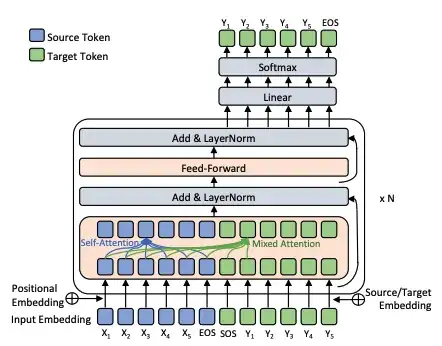

Normally, in order to do conditional text generation, people use an encoder-decoder architecture, that is, a full encoder-decoder Transformer instead of GPT-2, which only has the decoder part.
Nevertheless, while it was not meant to work the way you are using it, it is possible that this works. This kind of thing has been done before, for instance, in this NeurIPS 2018 article that uses only a Transformer decoder for machine translation, concatenating source and target sides, like you do:
You would need, nevertheless, to perform some adaptations. Specifically, the original GPT-2 vocabulary does not have the special tokens you use. Instead, it only has <|endoftext|> to mark the end. This means that if you want to use your special tokens, you would need to add them to the vocabulary and get them trained during fine-tuning. Another option is to simply use <|endoftext|> in the places of your <BOS>, <SEP> and <EOS>.
For GPT-2, there is only a single sequence, not 2. Therefore, the maximum token length would apply for the concatenation of text and reference summary.

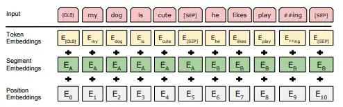

P.S.: I think that your use of <SEP> comes from the fact that other non-generative models like BERT, use similar special tokens ([SEP], [CLS]) and are specifically designed to receive two concatenated segments as input. However, BERT is not a generative language model, in the sense that it was not trained in an autoregressive manner, but with a masked LM loss:
