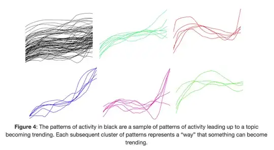

The basic idea of the method is to find the most common shapes in the time evolution hold those as the dominant classes. These would be various exponential shapes in your case (from Nikolov's blog post): Grouping of time series into classes

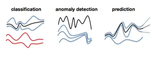

Then you can take your training data and choose the best shape for each of your cases. You can then use this data to train a classification algorithm. Finally you can use this to predict the outcome of your new data (from Nikolov's blog post): time series prediction through classification
