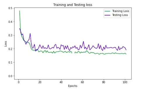

I am training an Image Classification Model and my train-test set distribution is 80-20.
  • After Training my train-test loss curve looks like this
Training and Testing Loss
As the model is converged after around 20-30 epochs and is not overfitting.
Can I also try to train the same model by merging my training and testing set hoping it would become more accurate with the increased size of training data ?
  • Is it a good idea to merge the train, test set in this case?
  • What are the disadvantages if I do so?

After you have finished with the model building process (in which it is assumed that you have used your test set once and only once for assessing the performance of your final model on unseen data), and before deploying your model, both common sense and standard practice say that you should re-train it on all the available data, including the portion that, until then, had been put aside as test. Leaving out available data is a luxury which normally we cannot afford; and, provided that there are no issues with your model building process, and your test set is qualitatively similar to your training one (an assumption implicitly always present), there is nothing to worry about.
Qualitatively speaking, this approach is similar with what we do with cross validation, where afterwards we routinely re-train the model using all the available data.

As soon as you train with data from a test set it is no longer a testing set. What you are suggesting would lead to you flying blind: it's possible that you will have better results because you're using more data but you simply would have no way of knowing. This is not a recommended strategy.
An alternative would be to change the train/test split to say 90/10 if you want to get more use out of your data - but this is only appropriate if you still have enough rows overall in your testing set.
On another note: if you want better results you could increase the complexity of your model. Maybe add more nodes in your hidden layer, try playing around with your learning rate (maybe it's too large and you're not approaching an acceptable local minimum?). These are the options that you should be looking into instead.
