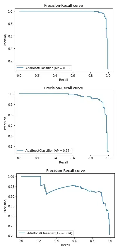

I then plotted the precision-recall curve for these 3 models. I chose this curve as I want to visualise how the models are performing, and I am not very interested in true negatives (the negative class is the majority class).
To plot the curve, I used ScikitLearn's plot_precision_recall_curve method, like so:
    from sklearn.metrics import precision_recall_curve
    from sklearn.metrics import plot_precision_recall_curve
disp = plot_precision_recall_curve(ada, X_test, y_test)
disp.ax_.set_title('Precision-Recall curve')
disp = plot_precision_recall_curve(ada_sm, X_test, y_test)
disp = plot_precision_recall_curve(ada_rus, X_test, y_test)
This resulted in 3 separate plots.

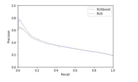

However, I want to have these 3 curves in one plot such that they can be easily compared. So I want a plot like the one in the article:
But I am not sure how to do this as the plot_precision_recall_curve method only takes one classifier as input.

Try using Matplotlib gca() method in this way you can indicate what axis you want to plot in
plot_precision_recall_curve(ada, X_test, y_test, ax = plt.gca(),name = "AdaBoost")
plot_precision_recall_curve(ada_sm, X_test, y_test, ax = plt.gca(),name = "SMOTE")
plot_precision_recall_curve(ada_rus, X_test, y_test, ax = plt.gca(),name = "RUS")
plt.title('Precision-Recall curve')
