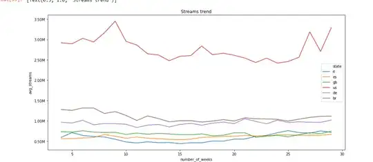

I'm studying the Spotify streams trend for different nations in order to show the impact of the pandemic on music listeners.
So far i retrieved my data, and plotted it.
Streams trend
Obviously, since the various nations have different numbers in population, spotify users ecc... this graphic doesn't tell much.

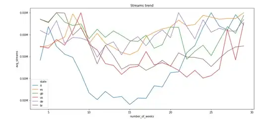

So i decided to scale every curve dividing its values by its peak.
So for example, the US has a maximum value of 3.50 million streams, i normalized that curve with that value and i did the same for all the other states (with their maximum value) and I obtained this:
Trends normalized
Could this be a good approach? In general which approach should I use if i want to compare different curves which have a really big difference in absolute values?

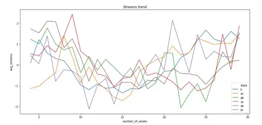

EDIT : In the end i normalized my data using a zscore normalization for each single line. So basically I computed the mean and standard deviation for each state and then I normalized the single state with its mean and std. This is the resulting plot:
normalized
Is this a good approach? Can I now compare the different trends and conclude that there's an overall decrease in the period between 10 and 15 weeks?

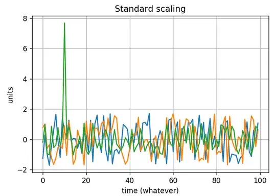

I think it would be better to use a standard scaler that removes the mean and divides by the standard deviation. See here for more info and an implementation using sklearn.
Why?

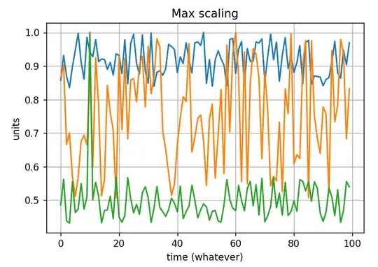

At least you should be aware that dividing by the maximum could hide smaller effects. In the case you have an outlier that has a very high value, you would loose the small changes in the corresponding curve. Moreover, you might not compare the same changes between all the curves.

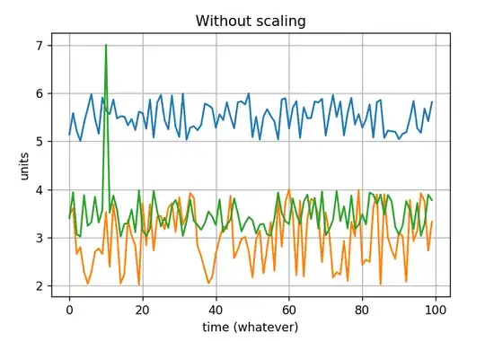

Here are some pictures to go with the Why? section above.
Raw data without scaling enter image description here enter image description here
