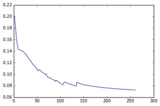

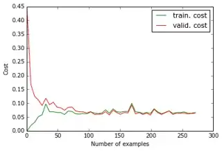

For now I have built a perceptron with one hidden layer and the output layer gives the pixels of the prediction. The two layers are dense and made of sigmoid neurons and I used the mean squared error as the objective. As the images are fairly simple and do not vary much, this does the job well: with 200-300 examples and 50 hidden units, I get a good error value (0.06) and good predictions on test data. The network is trained with gradient descent (with learning rate scaling). Here are the kinds of learning curves I get, and the error evolution with number of epochs:

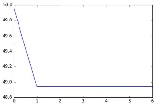

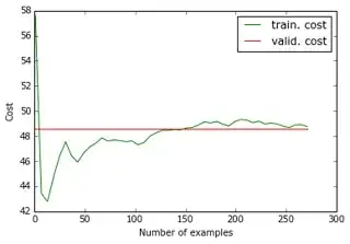

When I feed my reduced data set and its reduced targets to the network, the gradient descent converges very fast to a high error (around 50 !). You can see the equivalent plots as the ones above:
I had not imagined that a learning curve could start at a high value, and then go down and back up... And what are the usual causes of gradient descent stopping so fast? Could it be linked to parameter initialization (I use GlorotUniform, the default of the lasagne library).
Then I noticed that if I feed the reduced data but the original (uncompressed) targets, I get back the initial performance. So it seems that applying PCA on the target images was not a good idea. Why is that? After all, I just multiplied the inputs and the targets by the same matrix, so the training input and target are still linked in a manner that the neural network should be able to figure out, no? What am I missing?
