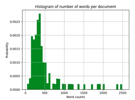

I'm working with a dataset $X$ (of length $N$) of count data, which looks like:

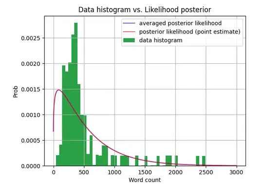

which returned the following posterior predictive distribution:
The first and second moments of the predictive posterior distribution are very close to those in the data (I've let the data have a huge impact in the posteriors since I've choosen a non-informative prior). Also, the point estimate posterior predictive (using $\mu_p$) does not differ from an averaged predictive posterior distribution over all possible values of $p$.
