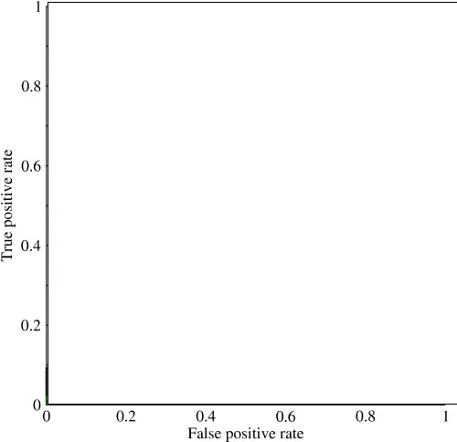

ROC axes
Now in this graph, TPR is specifically the ratio of true positive to all positives, and FPR is the ratio of false positives to all negatives. (Keep in mind, this is only for binary classification.) On a graph like this, it should be pretty straightforward to figure out that a prediction of all 0's or all 1's will result in the points of (0,0) and (1,1) respectively. If you draw a line through these lines you get something like this:

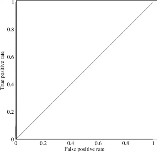

Kind of like a triangle
Which looks basically like a diagonal line (it is), and by some easy geometry, you can see that the AUC of such a model would be 0.5 (height and base are both 1). Similarly, if you predict a random assortment of 0's and 1's, let's say 90% 1's, you could get the point (0.9, 0.9), which again falls along that diagonal line.

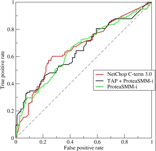

Now comes the interesting part. What if we weren't only predicting 0's and 1's? What if instead, we wanted to say that, theoretically we were going to set a cutoff, above which every result was a 1, and below which every result were a 0. This would mean that at the extremes you get the original situation where you have all 0's and all 1's (at a cutoff of 0 and 1 respectively), but also a series of intermediate states that fall within the 1x1 graph that contains your ROC. In practice you get something like this: Courtesy of Wikipedia
So basically, what you're actually getting when you do an AUC over accuracy is something that will strongly discourage people going for models that are representative, but not discriminative, as this will only actually select for models that achieve false positive and true positive rates that are significantly above random chance, which is not guaranteed for accuracy.

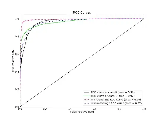

There are real benefits to using both. The big question is when. The first big difference is that you calculate accuracy on the predicted classes while you calculate ROC AUC on predicted scores. That means you will have to find the optimal threshold for your problem. Moreover, accuracy looks at fractions of correctly assigned positive and negative classes. That means if our problem is highly imbalanced, we get a really high accuracy score by simply predicting that all observations belong to the majority class. On the flip side, if your problem is balanced and you care about both positive and negative predictions, accuracy is a good choice because it is really simple and easy to interpret. However, you should always take an imbalance into consideration when looking at accuracy. Another thing to remember is that ROC AUC is especially good at ranking predictions. Because of that, if you have a problem where sorting your observations is what you care about ROC AUC is likely what you are looking for.
Here we compared those evaluation metrics on a real problem so feel free to check it out to get a bit clearer understanding. Happy learning! 24 Evaluation Metrics for Binary Classification (And When to Use Them) enter image description here
