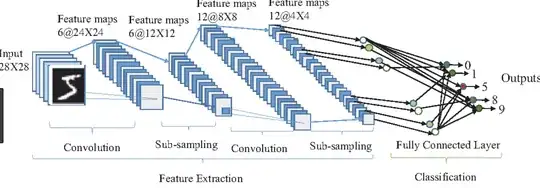

Here's a good reference image to keep in mind whenever working with CNNs (just to reinforce the intuition)
Hope that answers your questions.

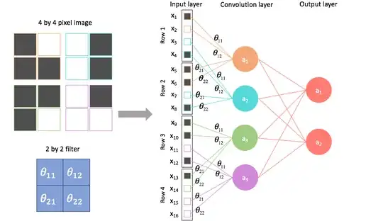

I will try to explain some key points of CNN to clarify above answers -

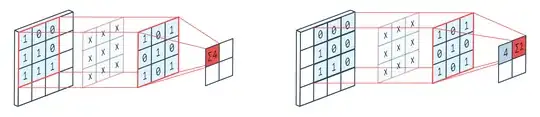

  • Each filter does a convolution across the n-D volume e.g. 3-D for RGB
  • So, it does an element-wise multiplication with the pixels, the output is summed and passes through an Activation function
  • This becomes the single element of one Feature map
  • Each filter creates one feature map.
  • Filter depth will be equal to the number of feature maps e.g. if you used 20 filters for the first RGB image. It will create 20 feature maps and if you use 5x5 filters on this layer, then filter size = 5x5x20.
  • Each filter will add parameters = its size e.g. 25 for the last example
  • If you want to visualize like a simple NN. See below image. All the theta are multiplied, summed, and pass through an activation function. Backpropagation happens in the same manner as in a Dense neural network
$\hspace{6cm}$Image Credit - Jeremy Jordan
You can read these references to develop a black and white intuition.
