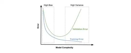

The Bias-Variance tradeoff
If your model is underfitting, you have a bias problem, and you should make it more powerful. Once you made it more powerful though, it will likely start overfitting, a phenomenon associated with high variance. For that reason, you must always find the right tradeoff between fighting the bias and the variance of your Machine Learning models.
(source)

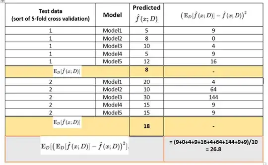

I am attaching below a screen shot of calculations performed to explain the definition of variance in Wikipedia.
Create 5-models from 5-different training datasets (similar to but not exactly, 5-fold cross-validation). That is prepare 5-models from differing training datasets. To each model, feed the same test data. Our test-data has two observations. Below are the results of predictions and calculations of variance. Extent of variance is 26.8

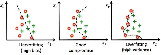

Well this image explains it all : in ML, you have a bias/variance dilemma : you want to create a model that is precise-enough to learn things from your data, but not perfectly-precised so it learns a tendancy and not the exact values of your training set.
Variance and Bias are to be taken together : on a same model, when you tweak to lower Variance, you'll automatically increase Bias.
Your job is then to get the good compromise, as show in image : a variance high enough (ie a bias low enough) to make good predictions and learn something from your train, but not a too high variance (ie not a too low bias) to avoid overfitting.
