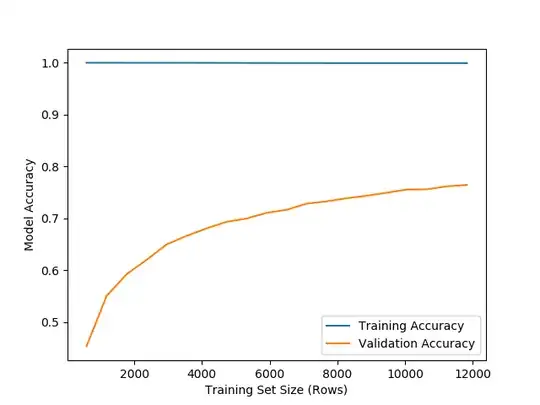

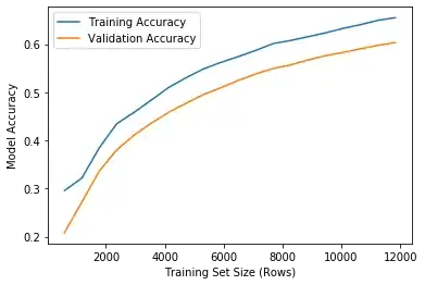

Update: Here are learning curves for C = 1 and C = 1e5. As I mentioned in passing earlier, the training curve seems to always be 1 or nearly 1 (0.9999999) with a high value of C and no convergence, however things look much more normal in the case of C = 1 where the optimisation converges. This seems odd to me...
C = 1, converges
C = 1, converges
C = 1e5, does not converge C = 1e5, does not converge

Thanks to suggestions from @BenReiniger I reduced the inverse regularisation strength from C = 1e5 to C = 1e2. This allowed the model to converge, maximise (based on C value) accuracy in the test set with only a max_iter increase from 100 -> 350 iterations.
The learning curve below still shows very high (not quite 1) training accuracy, however my research seems to indicate this isn't uncommon in high-dimensional logistic regression applications such as text based classification (my use case).
"Getting a perfect classification during training is common when you have a high-dimensional data set. Such data sets are often encountered in text-based classification, bioinformatics, etc."
Learning curve for C = 100, max_iter = 350, solver = lbfgs
