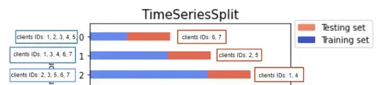

Here is a solution based on @NoahWeber and @etiennedm answers. It is based on a juxtaposition of splittings, a 1) repeated k fold splitting (to get training customers and testing customers), and 2) a time series splits on each k fold.
This strategy is based on a time series' splitting using a custom CV split iterator on dates (whereas usual CV split iterators are based on sample size / folds number).
An implementation within sklearn ecosystem is provided.

As a first porint, when you say "The idea is that this model is deployed and used to model new customers" I guess you mean and used to infere on new customers, is it correct? I can think of two possible options:
  1. following the properties you impose, you can first make use of the TimeSeriesSplit cross-validator by scikit-learn, with wich you get the time-ordered indices of each train-validation split, so that you can use them later on the clients IDs you decide to fulfill the second condition, something like: enter image description here
  2. As a second option, you could try to apply clustering on your clients, based on certain features, and build as many models as clients types you get (each cluster having n clients history data). This would solve a possible problem I see in your approach, which is (due to the second restriction) not using a client whole history data both for training and validating
