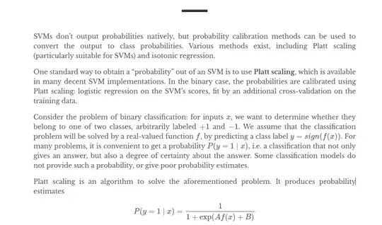

Might be late but one alternative for this and actually any classifier that does not return probabilities such as SVM is to use calibration either Platt scaling or Isotonic regression
In this way, you will have a classifier that actually returns a probability i.e you will be able to calculate ROC Curve
Reference:
https://mmuratarat.github.io/2019-10-12/probabilistic-output-of-svm#:~:text=SVMs%20don't%20output%20probabilities,the%20output%20to%20class%20probabilities.&text=In%20the%20binary%20case%2C%20the,validation%20on%20the%20training%20data
