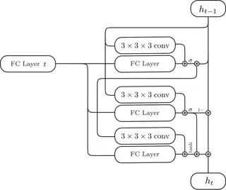

I am trying to implement a custom GRU model that is shown in this paper 3D-R2N2 The GRU pipeline looks like:
Gru Model For 3D-R2N2
The original implementation is theano based and I am trying to apply the model in tf2/Keras.
I have tried to create a custom GRU Cell from keras recurrent layer.
The input to the GRU model is of shape (Batch Size,Sequence,1024) and the output is (Batch Size, 4, 4, 4, 128). I have issues implementing the convolution layer present in the diagram due to shape incompatibility issues.
This is my attempted GRU Cell:

Equations for the GRU gates are:
GRU Gates
Testing

I found a Tensorflow 1 implementation which may help
def fcconv3d_layer(h_t, feature_x, filters, n_gru_vox, namew, nameb):
    out_shape = h_t.get_shape().as_list()
    fc_output = fully_connected_layer(feature_x, n_gru_vox * n_gru_vox * n_gru_vox * filters, namew, nameb)
    fc_output = relu_layer(fc_output)
    fc_output = tf.reshape(fc_output, out_shape)
    h_tn = fc_output + slim.conv3d(h_t, filters, [3, 3, 3])
    return h_tn
Fully connected layer
def fully_connected_layer(x, n_out, namew, nameb): shape = x.get_shape().as_list() n_in = shape[-1] fcw = create_variable(name = namew, shape = [n_in, n_out], initializer = tf.uniform_unit_scaling_initializer(factor = 1.0)) fcb = create_variable(name = nameb, shape = [n_out], initializer = tf.truncated_normal_initializer())
fcw = tf.get_variable(name = namew, shape = [n_in, n_out], initializer = tf.uniform_unit_scaling_initializer(factor = 1.0))
fcb = tf.get_variable(name = nameb, shape = [n_out], initializer = tf.truncated_normal_initializer())
return tf.nn.xw_plus_b(x, fcw, fcb)
Leaky relu layer
def relu_layer(x): return tf.nn.leaky_relu(x, alpha = 0.1) def create_variable(name, shape, initializer = tf.contrib.layers.xavier_initializer()): regularizer = tf.contrib.layers.l2_regularizer(scale = 0.997) return tf.get_variable(name, shape = shape, initializer = initializer, regularizer = regularizer)
def recurrence(h_t, fc, filters, n_gru_vox, index): u_t = tf.sigmoid(layers.fcconv3d_layer(h_t, fc, filters, n_gru_vox, "u_%d_weight" % (index), "u_%d_bias" % (index))) r_t = tf.sigmoid(layers.fcconv3d_layer(h_t, fc, filters, n_gru_vox, "r_%d_weight" % (index), "r_%d_bias" % (index))) h_tn = (1.0 - u_t) * h_t + u_t * tf.tanh(layers.fcconv3d_layer(r_t * h_t, fc, filters, n_gru_vox, "h_%d_weight" % (index), "h_%d_bias" % (index))) return h_tn
Build 3d gru network
def build_3dgru(features): # "features" is a tensor of size [bs, size, 1024] # Split the "features" into many sequences.
with tf.variable_scope("gru", reuse = tf.AUTO_REUSE): shape = features.get_shape().as_list()
newshape = [shape[1], shape[0], shape[2]] # [size, bs, 1024]
features = tf.reshape(features, newshape)
    h = [None for _ in range(shape[1] + 1)]
    h[0] = tf.zeros(shape = [shape[0], n_gru_vox, n_gru_vox, n_gru_vox, n_deconv_filters[0]], dtype = tf.float32)
    for i in range(shape[1]):
        fc = features[:, i, ...]
        h[i + 1] = recurrence(h[i], fc, n_deconv_filters[0], n_gru_vox, i)
    # [bs, 4, 4, 4, 128]
    return h[-1]
