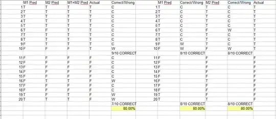

Here is a simple balanced example (50% of the labels are actually T and 50% are actually F), where I think stacking or ensembling algorithms will still give the same result as the original model. In this case, for the ties (1 F and 1 T), I decided to select T. The same problem would occur if I selected F instead. This is a little more complicated if I used the predict_proba, but think the same problem would occur.

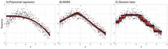

2. Bagging based Ensembling
A model with very high variance is prone to overfit. We can convert this challenge to our advantage if we figure out a way to average out the variance. This is the logic behind bagging based model.
Intuition - At a very high level, the high variance model when built on a different random sample will create decision boundaries which when averaged will smoothen the prediction and variance will be reduced.
An intuitive example is Here

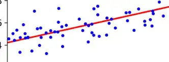

Why not High Bias models - A high bias model (e.g. A Regression Line) will not change much with every sample as the sample will have the roughly same distribution and the slight difference doesn't impact these models. So, it will end up almost the same models for every sample.
As shown in this example for 3 different models.
$\hspace{4cm}$Ref - Hands-On Machine Learning with R, Bradley Boehmke & Brandon Greenwell

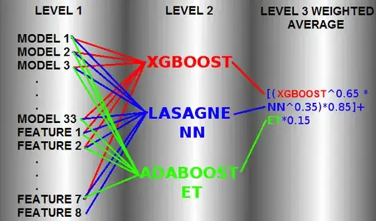

This was a very simple explanation of generalized stacking approach but stacking has been extensively used in competitions. To an unimaginative level which is almost impossible to comprehend and explain.
As done in below mentioned approach Ref
$\hspace{2cm}$enter image description here
