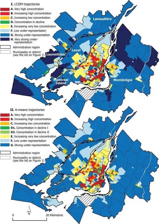

I am probably very late with my answer, but if you are still dealing with geo clustering, you may find this study interesting. It deals with comparison of two fairly different approaches to classifying geographic data: K-means clustering and latent class growth modeling.
One of the images from the study:
The authors concluded that the end results were overall similar, and that there were some aspects where LCGM overperfpormed K-means.
