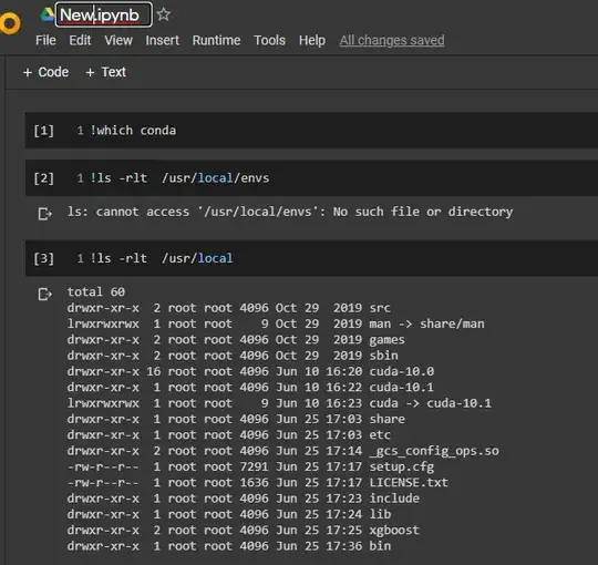

Found a way to get Miniconda working in Google colab. For now, use source activate, not conda activate in the 2nd cell. Still working out the bugs with using conda to activate.
Full Notebook demo here:
https://donaldsrepo.github.io/Notebooks/GoogleColabCondaCreateEnv.html
github with demo notebook:
https://github.com/donaldsrepo/SampleNotebooks/blob/master/CondaCreateEnv/GoogleColabCondaCreateEnv.ipynb
Google uses Python 3.6.9 by default. I created an environment using Python 3.6.10.
Steps to follow:
  1. Install miniconda
  2. Create a new environment
  3. Run some python code to test the environment is being used

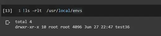

Note that version 3.6.10 is the one installed in my personal conda environment. You can also see your new environment here:
Current Google Colab Notebook
A few things to point out:
  1. If you open a new notebook, your new environment does not exist. Seems to be stored in a transient location, similar to docker.
New Google Colab Notebook
