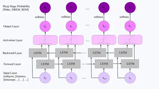

The short answer is no, a bidirectional architecture will still take in a variable sequence length. To understand why, you should understand how padding works.
For example, let's say you are implementing a bidirectional LSTM-RNN in tensorflow on variable length time series data for multiple subjects. The input is a 3D array with shape: [n_subjects, [n_features, [n_timesteps...] ...] ...] so to ensure that the array has consistent dimensions, you pad the other subject's features up to the length of the subject with features measured for the longest period of time.
Let's say subject 1 has one feature with values = [22,20,19,21,33,22,44,21,19,26,27] measured at times = [0,1,2,3,4,5,6,7,8,9,10]. subject 2 has one feature with values = [21,12,22,30,13,42,20] measured at times = [0,1,2,3,4,5,6]. You would pad features for Subject 2 by extending the array so that the padded_values = [21,12,22,30,13,42,20,0,0,0,0] at times = [0,1,2,3,4,5,6,7,8,9,10], then do the same thing for every subsequent subject.
This means the number of timesteps for each subject can be variable, and the merge you refer to occurs with the dimension for that particular subject.
Below is an example of a bidirectional LSTM-RNN architecture for a model that predicts sleep stages for different subjects using biometric features measured over variable lengths of time.
