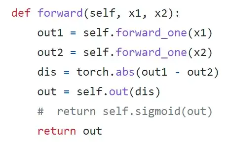

You could have a single network, feed both inputs separately, compute the distance/loss, then perform backpropagation.
Or
(as in the cited paper) you could initialize a network, and then create a parallel twin of that network. Because both networks see the same loss, they will remain identical after backpropagation.
The paper is explained in the form of the latter. In fact, I've always seen it explained in the form of the latter.
I can tell you in terms of implementation, its done using the former. As a matter of fact, this is directly from the GitHub for the cited paper.
