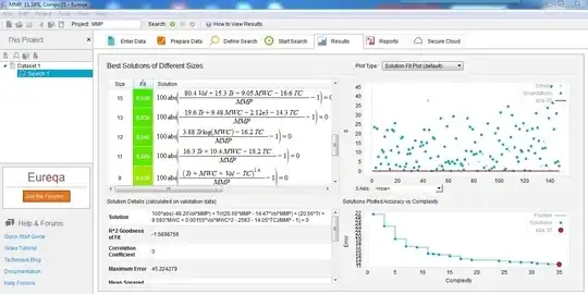

The function approximation method is called "Symbolic Regression" or "Gene Expression Programming" (GEP). If you don't have to re-invent the wheel, there are few shareware (Eureqa, GeneXproTools, DTReg) and one python library.
You can get the trial version of Eureqa from here. However, the academic version is free and fully functional. You can also get the DEMO version of GeneXproTools, from here, or DTReg from here. I used to use them for few years, but I recommend to use Eureqa. It is very easy to use and can be used for both classification and regression. All the genetic algorithm settings are set behind the scene so you only need to select the functions and mathematical operations you need. You can also define your own custom fitness function. In addition, it is multi-threaded and also can be run on AWS cloud, and it converges very quickly.
GeneXproTools and DTReg are for advanced users, but I personally don't recommend them, especially the GeneXproTools. It is single-threaded and its development seems to be stopped since 2015.
If you can code in python, you can also use geppy library. The Github repo is here. I've never used it because I have done whatever I needed with Eureqa.
Final note: If you don't have to solve your problem programmatically, go for Eureqa only.
