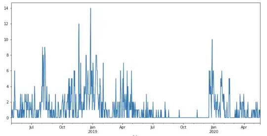

I have a time series data. It has daily frequency.
I want to forecast the data for the next week or month with an ARIMA model.

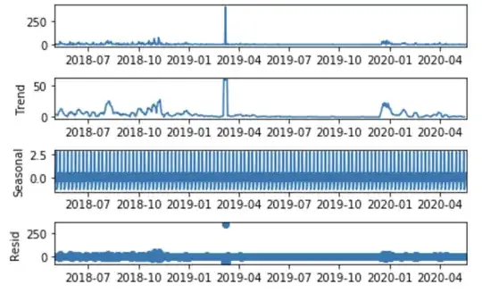

This is a chart of my time series data:

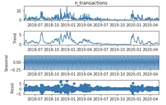

First I use the method seasonal_decompose from stats model to check the trend/sessionality/residual looks like:
from statsmodels.tsa.seasonal import seasonal_decompose
result = seasonal_decompose(df['n_transactions'], model='add')
result.plot();

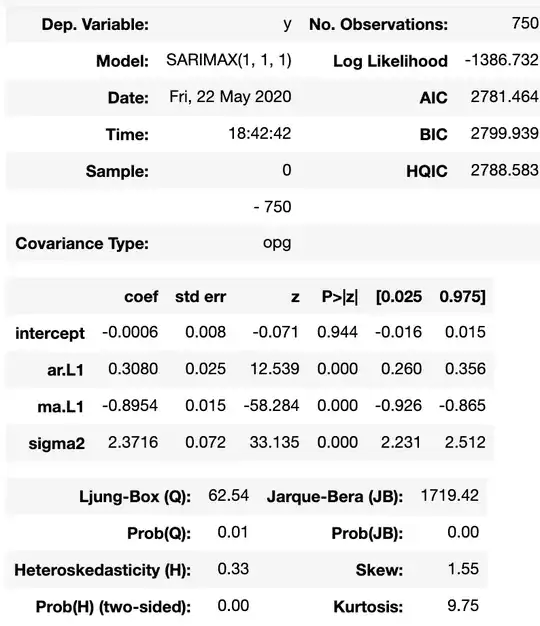

I train my model with this paremeters:
train = df.loc[:'2020-05-12']
test = df.loc['2020-05-13':]
model = SARIMAX(train['n_transactions'],order=(1, 1, 1))
results = model.fit()
results.summary()

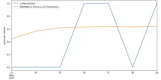

I calculate the predictions:
start=len(train)
end=len(train)+len(test)-1
predictions = results.predict(start=start, end=end, dynamic=False, typ='levels').rename('SARIMA(0,1,3)(1,0,1,12) Predictions')
ax = test['n_transactions'].plot(legend=True,figsize=(12,6),title=title)
predictions.plot(legend=True)
ax.autoscale(axis='x',tight=True)
ax.set(xlabel=xlabel, ylabel=ylabel);
But the model can't obtain good results, why?

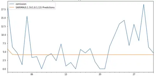

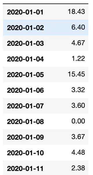

Edit
I have used instead of counts the revenue that I obtain for this counts as you suggested me that may be this would be the problem:
But the model is not obtaining good results:
What conclusion can I extract from here?
