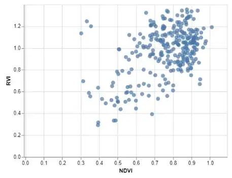

And scatterplot of data:
How should I proceed with this analysis?
